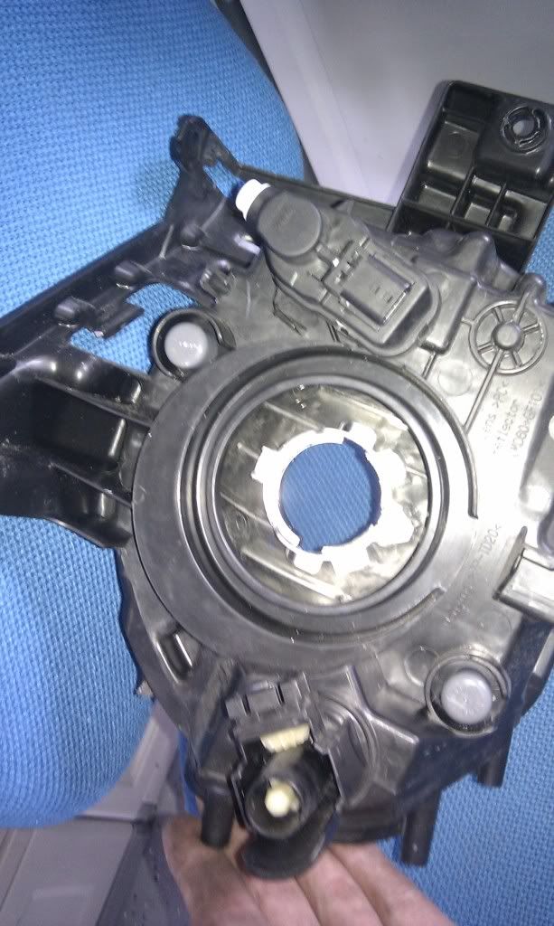

Remove everything from the backside, rubbers, metal screw, holder of the H4 lamp

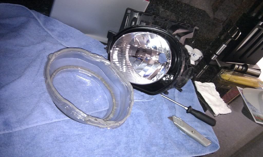

Use 2 flat screwdrivers, one the get between the housing and the front lenscover and the other to get it between the clips

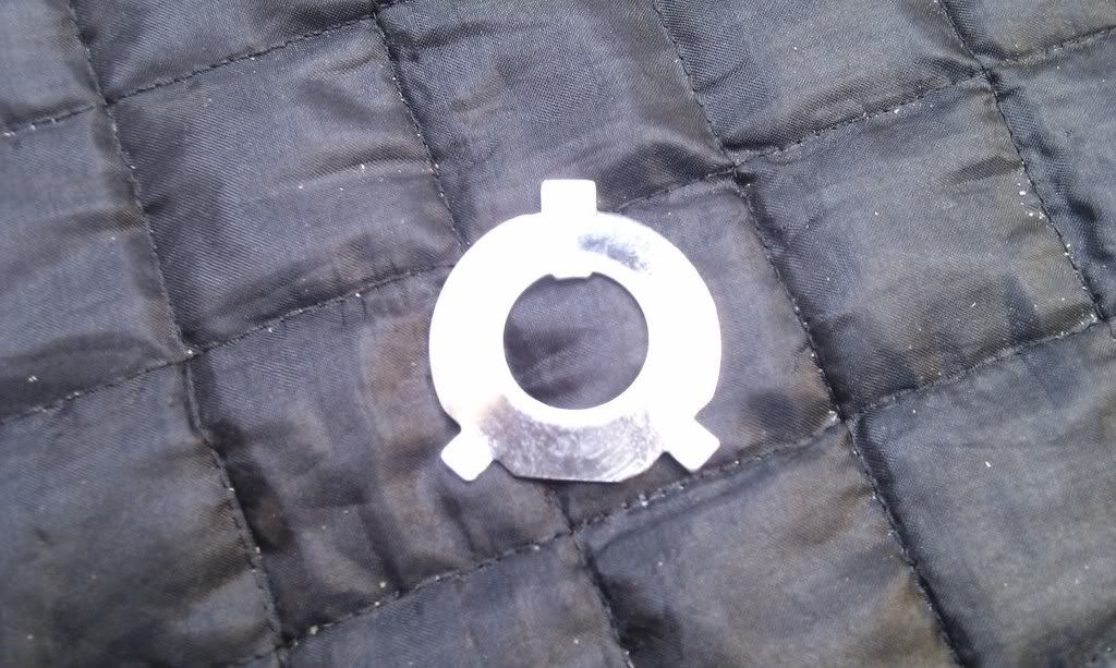

This is the H4 lockring, wich you have to cut a lil bit for the wiring for the light

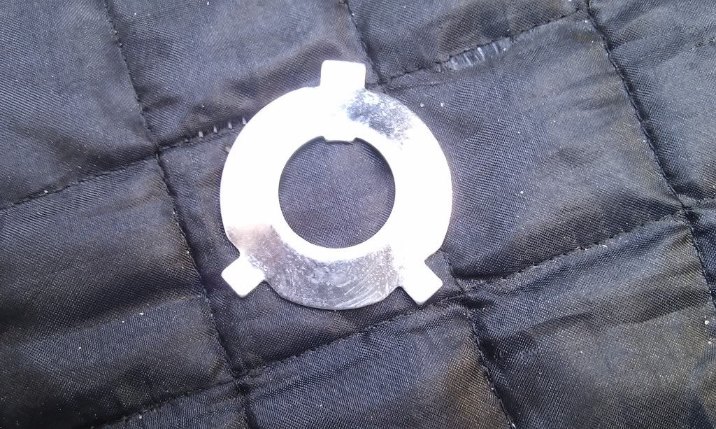

Here you see the diffrence, used a file the make it not round, but flat
Then the lock ring on the back side, make it tide

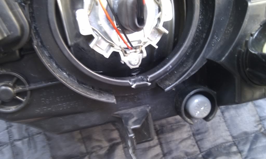

Then I made a thing to fill the whole in the OEM rubber housing, to make it water tight
And then here you see the wiring for the light (wich can make the projector switch beteen normal beam and high beam)

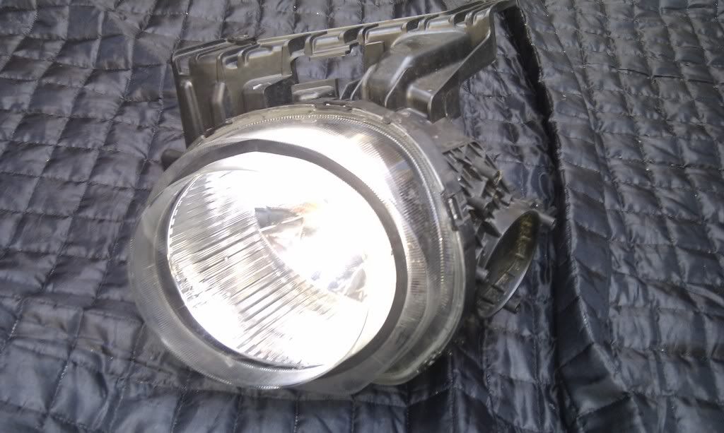

before I forget, for the xenon haters(without the projectors)
this is on the light when you take it off:
so yes, there can be fitted xenon with using the same reflectors
:D
