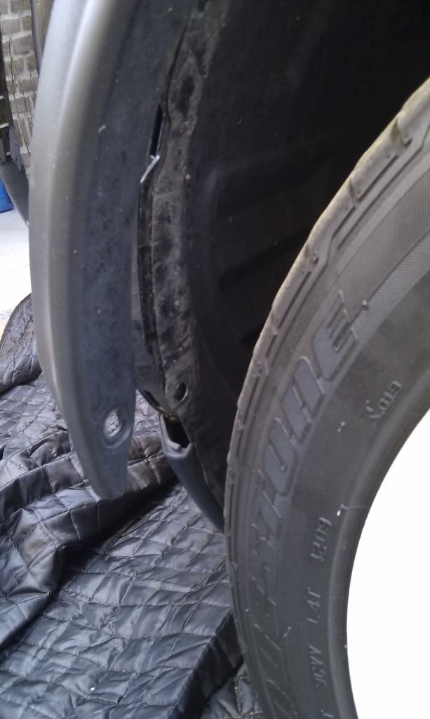

the remove the plastic clip in the wheel fender
the pull the fender from the car off

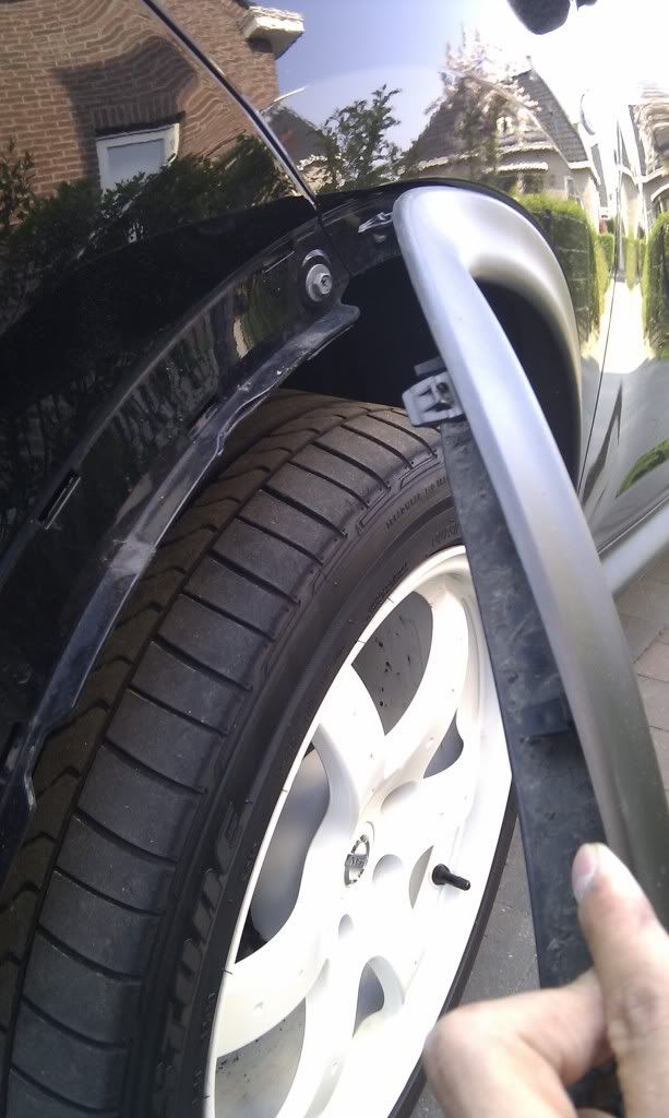

behind that there is one bolt (on each side)
The you can pull the bumper towards you, becare full with the part onder the upper lights

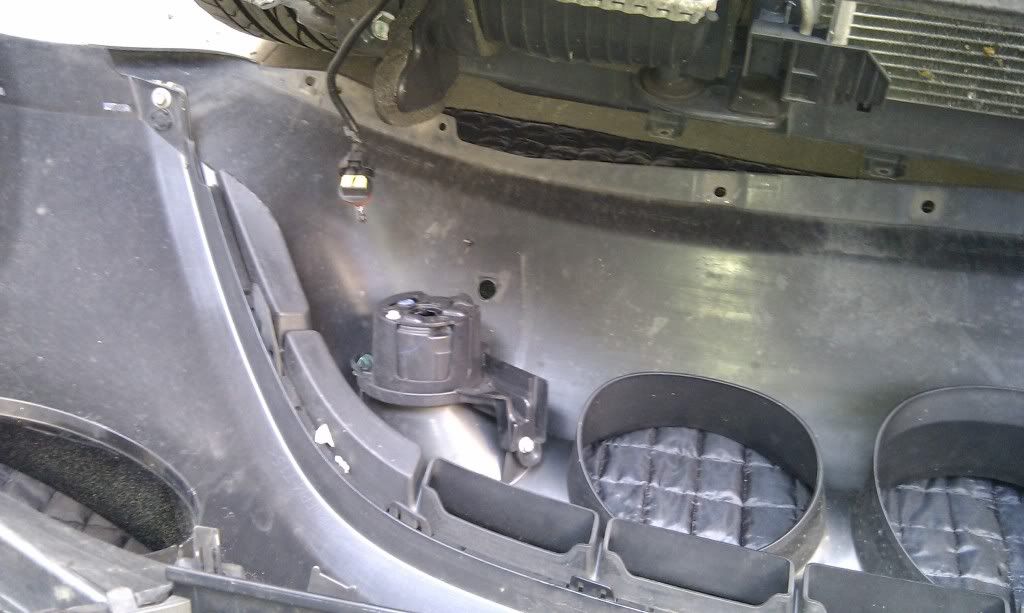

After that the bumper will come off and release the foglights
then you will have this
good luck, putting back I advise, use 2 people, start with it other way around
