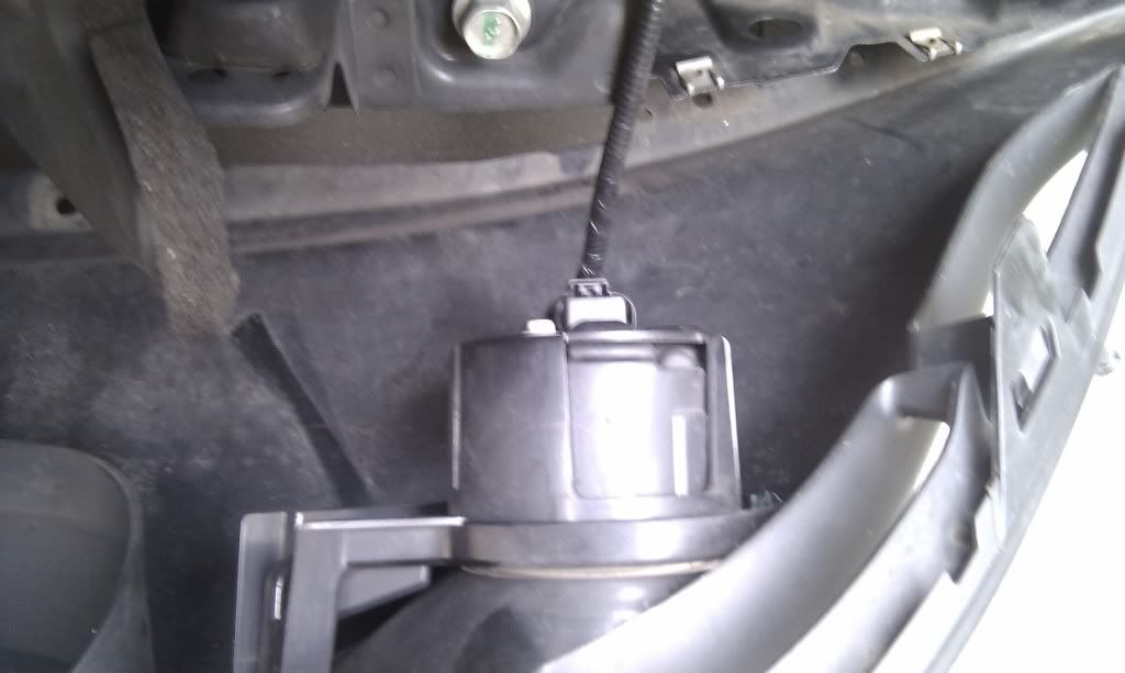

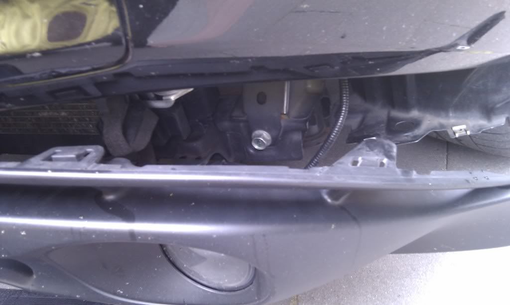

Losen the clips

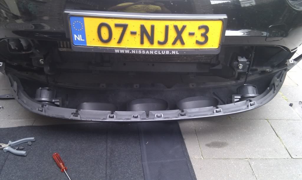

Then you can pull the plastic part towards you, first time it a bit difficult

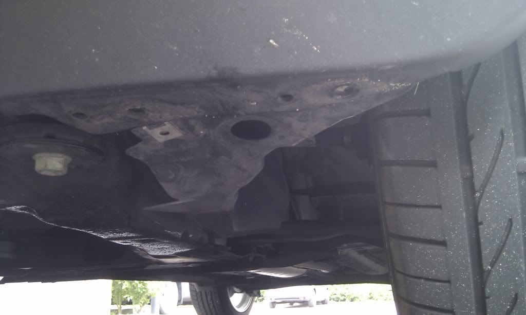

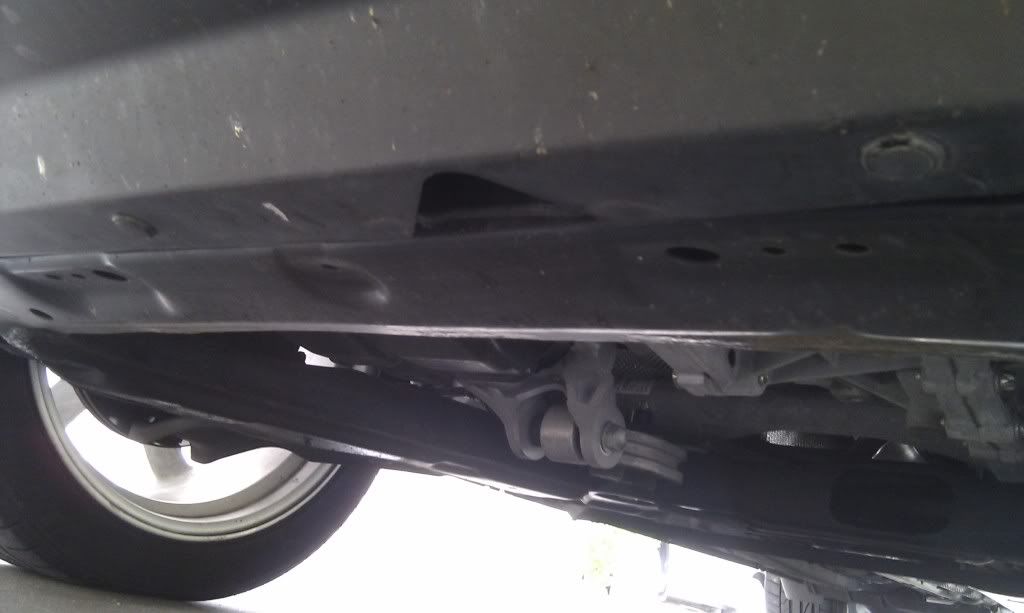

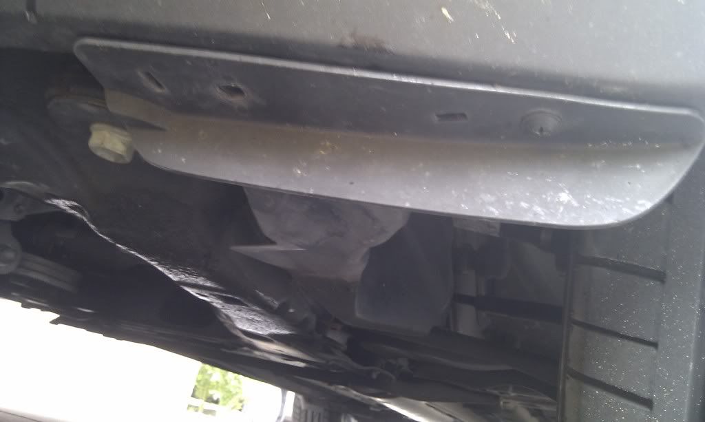

Remove 3 clips under your bumper
Remove these wind things or something, just twoo screws

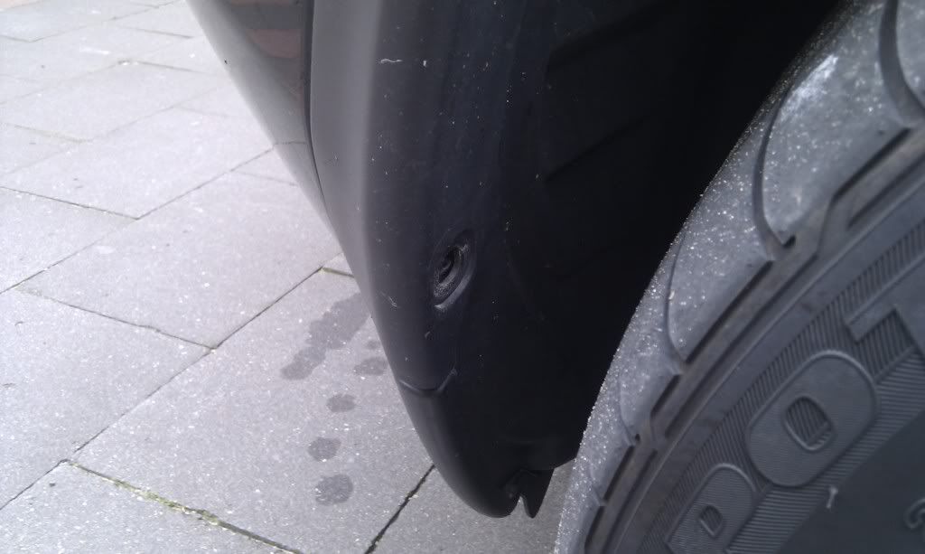

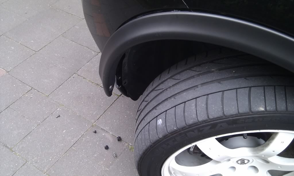

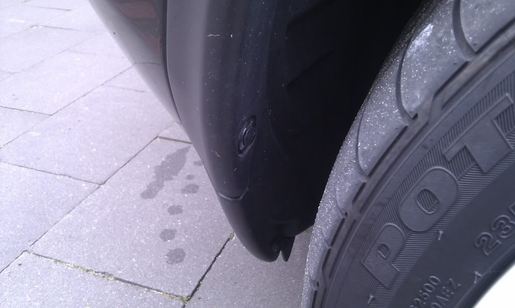

Rotate your wheel to the outside

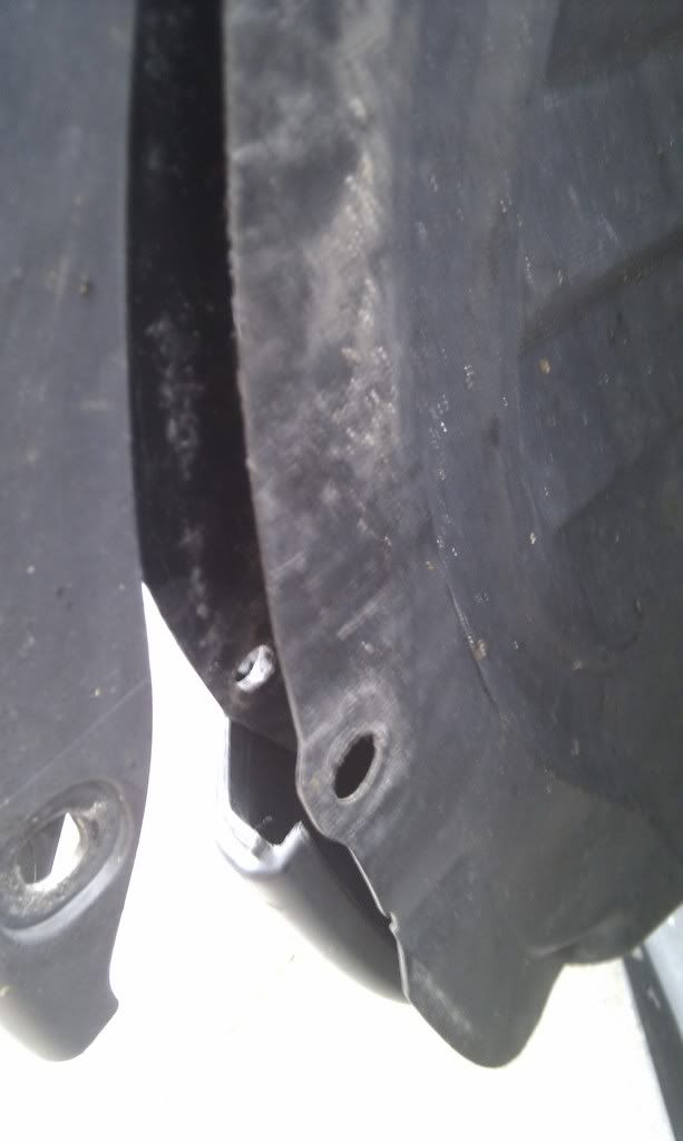

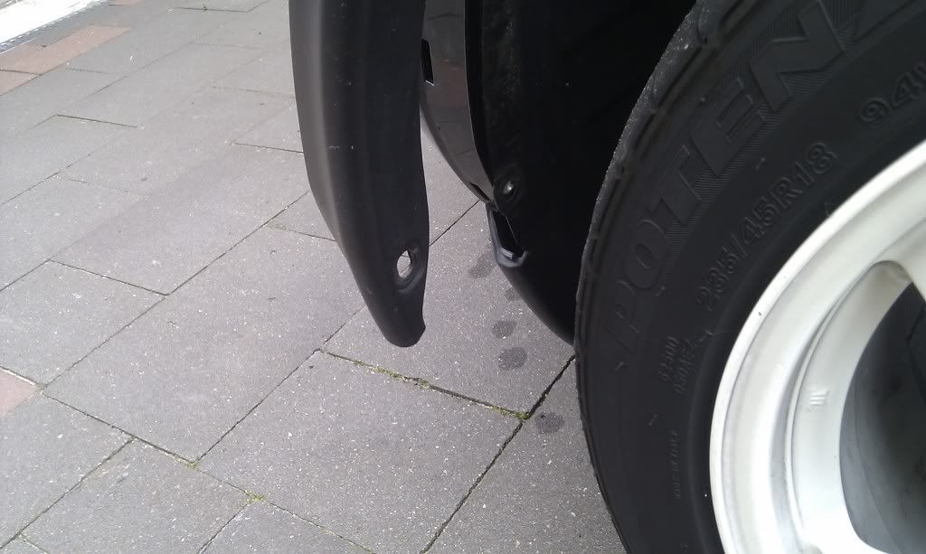

Pul the plastic around the wheel arce toward you
Behind you'll see an other clip and one bolt, remove them (don;t forget the other side and rotate the wheel to the other outside

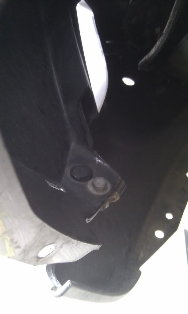

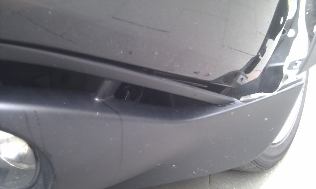

Pull the lower part towards you gentle
Voila

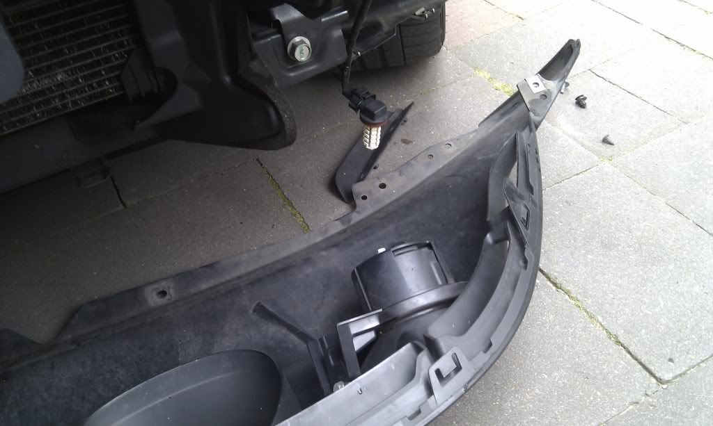

Losen your fog light and there you go
otherwayaorund to get it back on
