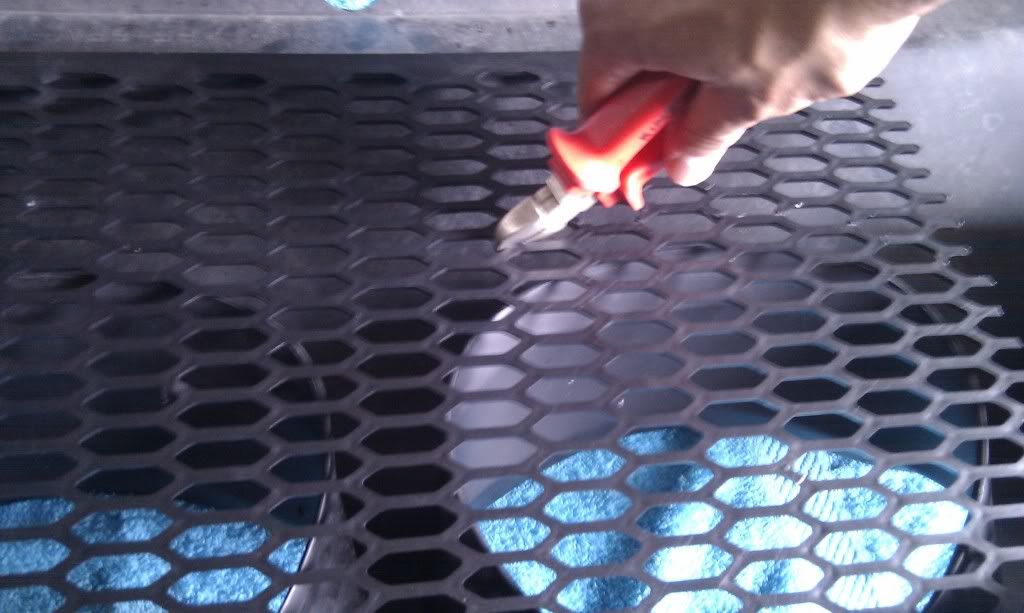

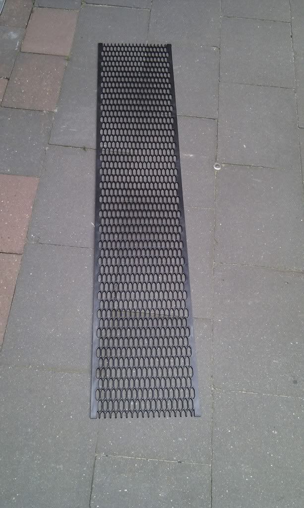

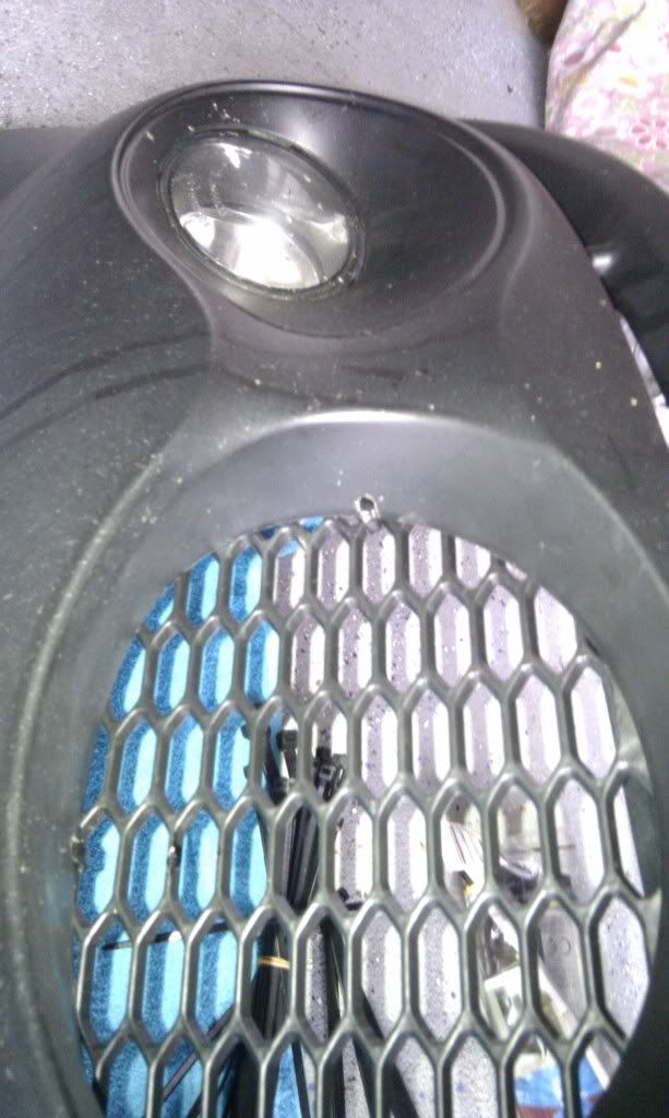

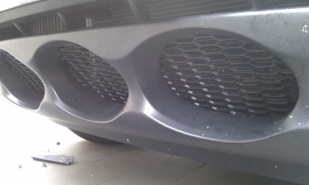

the we take some plastice haze (I like this more the the ordinary metal one
Measure the size

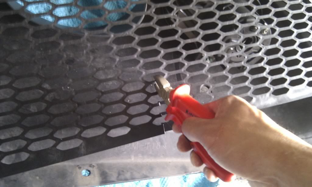

Cut it, plastic is very easy to cut

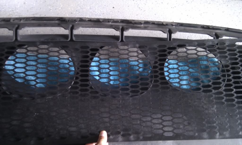

See if it fits

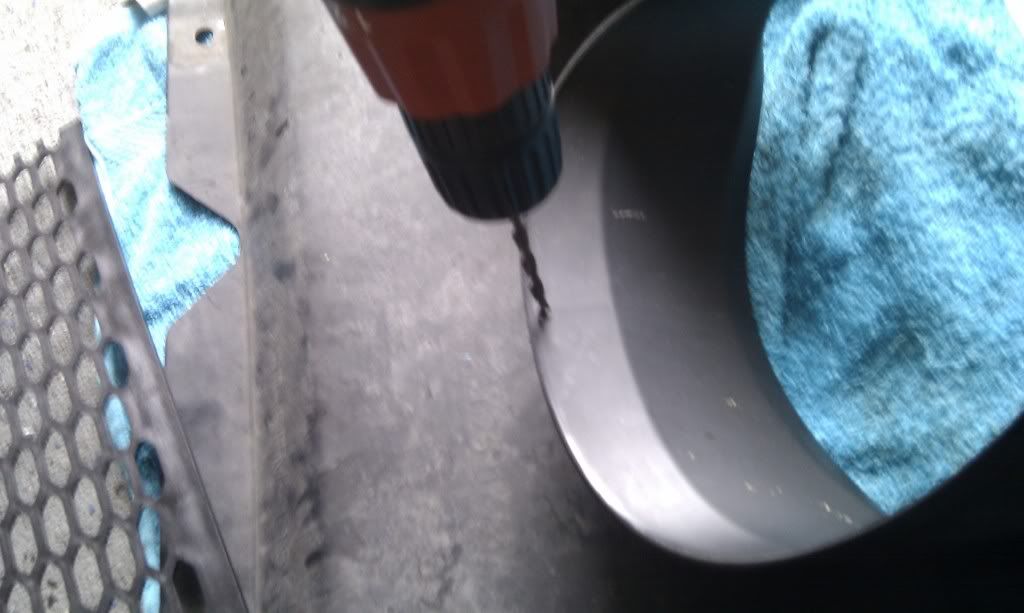

Dril little holes, just big enough for a ty-rap

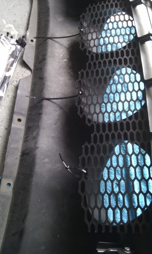

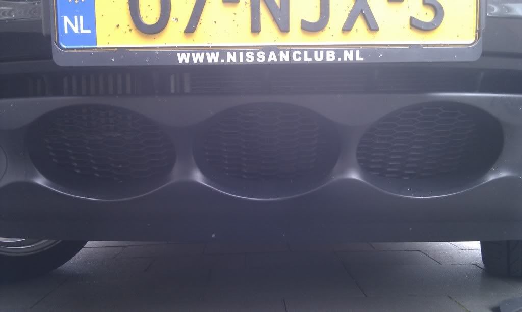

Connect the grill with the ty-raps

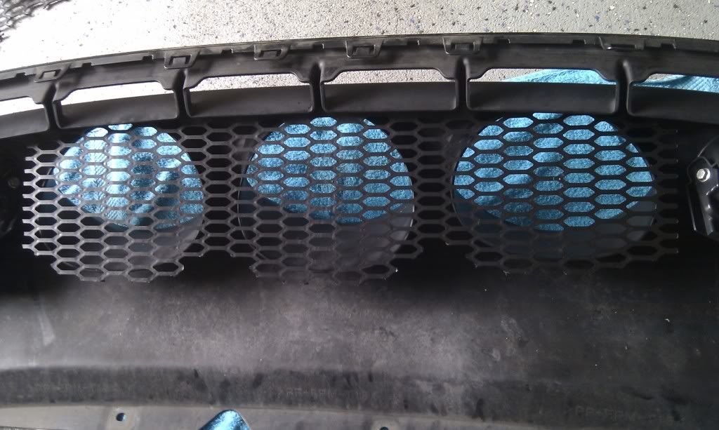

I just fixed it 3 on the bottom an tww on the sides
And mount back the lower part.
Takes about 30 minutes and 10 euro's for the plastic
You can always buy the ones from customgrills or make your own ;)
